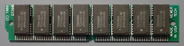

Newer Tech IIfx 4MB SIMMs in 1989?
One Macintosh IIfx computer that I received came with 4 sticks of 4MB RAM. What makes this interesting is the copyright date of 1989. The IIfx shipped in March 1990.
Since this was a new memory design, the 1989 date is not likely leftover from 30-pin SIMM gerbers. Instead, it seems like Apple must have made the pinouts and specifications available prior to the computer's release. I know the Laserwriter NTX also used 64-pin SIMMs.
I suppose this layout could have been generated for 1 MB SIMMs and then the boards reused for 4 MB SIMMs later on. But, I like to imagine how expensive these would have been if they were produced at the IIfx launch.
