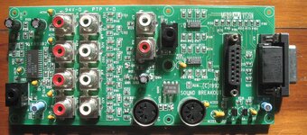

Got mine open and have documented the PCB for starting a schematic development thread. IOW, it's not a simple pinout development project you've got started here.
Three generic ICs may support Sound OUT and MIDI I/O schematic development for doing a limited function PCB. MEDIAVISION's THUNDER custom IC appears to be a condensation of logic and DAC supporting the five analog Sound INPUT channels at first glance.

DO NOT try to take one apart, it's a hot mess and needs to go back together with hot glue!

You'll have to get someone involved who does traditional schematic development to get anywhere with that project. I just kicked it off, if you can link to or upload the Spec Sheets 0f the three generic ICs that would be a great leap forward.
I'm keeping my board out in order to buzz connections on traces that may be obscured on the component side. Interestingly, there are at least a couple of traces that go nowhere at all that appear to be the equivalent of alternate ground lines for preventing crosstalk digital signals, guessing they're shielding for analog transmission lines?
Interestingly, there is no RFI shielding for the case at all.

Well, the LF247s are quad Opamp ICs, and the HP 6n136 appears to be MIDI related, so anyone with a decent knowledge of analog electronics could probably figure this out easily enough (disclaimer: that's not me!).
I don't know what that Thunder MVA611 does, though. My best guess is that it's also related to MIDI somehow?
