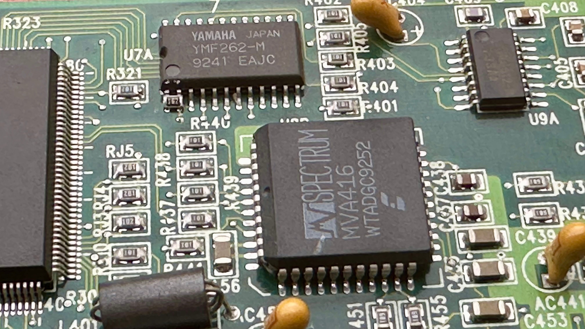

Why don't you use a continuity tester to see what pins 4 and 5 are connected to from the OPL? See if they go to some logic, or a custom chip, or what? It would be informative.
OPL3 pins 4 and 5 go to pin 125 and 126 on the MVD101-D "Spectrum" IC respectively. The chip is definitely hooked up and running, it's connected to 5V from the slot, and the data lines are connected to the MVD101-D as well.

The MVD101D appears to partly function as a bus decoder. The PAS16 card's hardware resources are soft configurable. MVSOUND.SYS (and likely the Mac extension) tell the chip where to connect the IRQ and I/O addressing lines of the various parts of the card. Normally Adlib compatible cards wire up the OPL3 directly to 0x388h. Its likely those lines aren't connected at all until the MVD101D is programmed at boot. I'm actually surprised Media Vision recycled this chip for Nubus as they needed to add additional bus interface logic regardless.
Traced the board and can confirm @NJRoadfan findings
The YMF bus lines are wired to the MVD101D AND a 74LS245 buffer (bottom right, AU12F) AND to the MVA508 (mixer chip) through R301-R308 100Ω resistors.
I see no continuity between the YMF and the NuBus part of the card (left). Maybe missed something.
Output is wired to a YAC512 DAC (U9A) and get lost somewhere into the analog domain.
Also there is a "nice" pull-up resistor on the /IRQ line, dunno how it can work that way…
