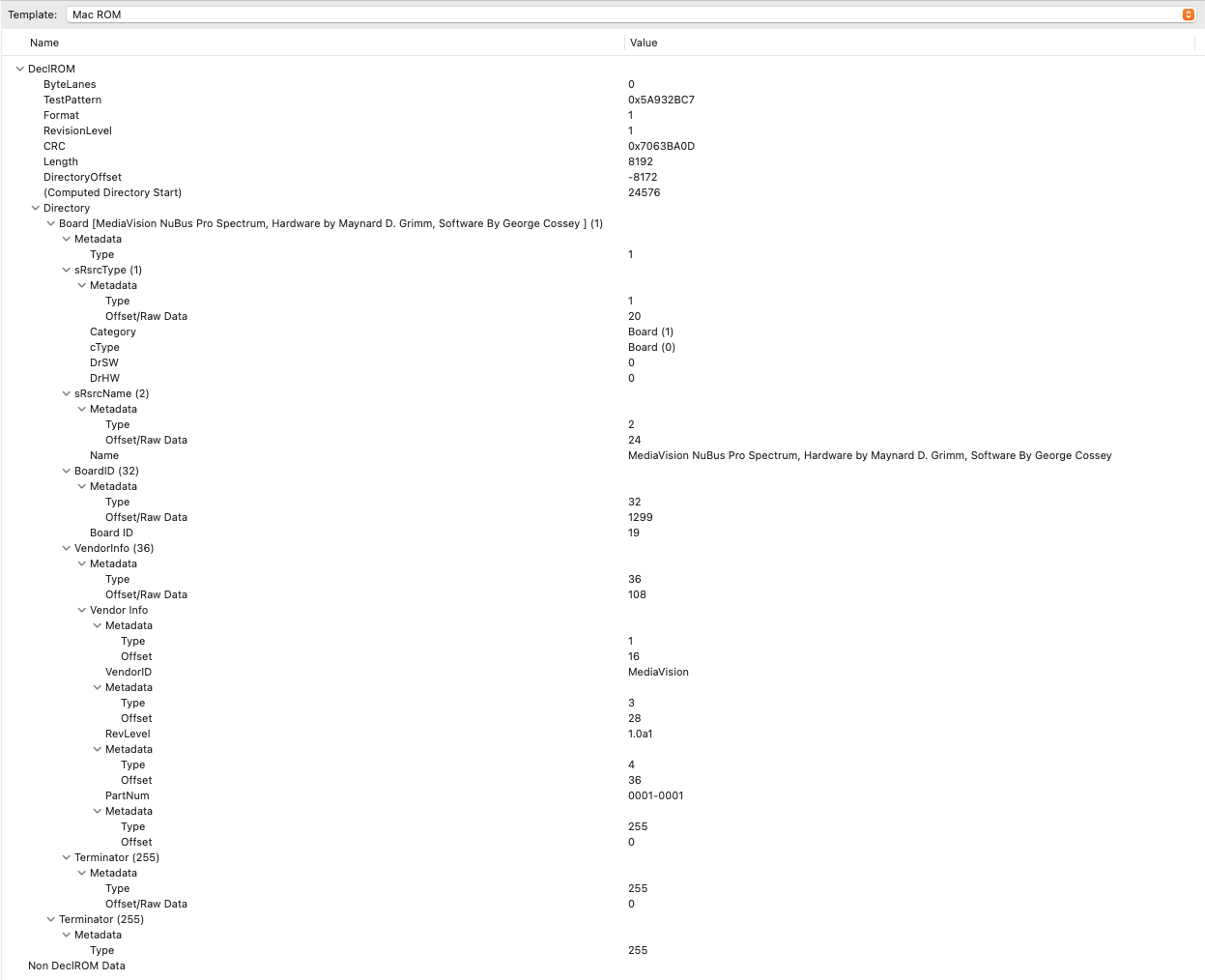

The compiled application included is hardcoded to Slot D since that's where my PAS16 is right now - if you need a different slot, change nubusSlot in the code and recompile. (When I make an actual meaningful program it will allow selection, or maybe detection if I can find a good way to do that - probably by probing for the DeclROM)
