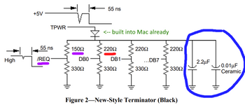

Fortunately, Apple provided the exact circuitry and differences in Macintosh "Technical Note DV 15 - SCSI Termination" (attached).
There are three differences:
1. The addition of a 2.2 uF capacitor connected between terminator power and ground
2. The addition of a 0.01 uF capacitor connected between terminator power and ground
3. The reduction in pullup resistance only on the REQ pin, dropping from 220 ohms to 150 ohms. Note the other pins remain at 220 ohms.
The purpose of these changes is to prevent the REQ pin from accidentally dropping low when a bunch of other SCSI pins are quickly pulled down intentionally, as might happen at high speed. The capacitors provide a little bit of local power storage to supply during rapid changes, and the lower resistance on the REQ pullup makes it a little harder to pull down.

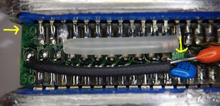

Flip it over to notice the interesting resistor packs have dual 220 ohm / 330 ohm resistors. I guess there was enough demand for SCSI terminators to manufacture special parts like this.
Flip the terminator back to the side with the capacitors. All you need to do is solder a 470 ohm resistor between the center pin (TERM power) and pin 48 (REQ). A little heatshrink tubing or kapton tape prevents a short.
A 470 ohm resistor in parallel with a 220 ohm resistor (already installed) = ~150 ohms.
Reassemble the terminator. I had to nibble a bit of the tan plastic insert away to compensate for the space taken up by the resistor and heatshrink tubing. For the metal wrapping, you can resolder the peeled shielding or get a roll of grounding tape (aka EMI shielding tape, aka double-sided conductive copper foil tape) from Amazon.

On the other side, we see the resistor arrays. They also look just like those on the gray Apple passive terminator. Hey!!! Wait a minute. I thought this was supposed to be a fancy IIfx terminator? Where's the special 150 ohm resistor for /REQ? This is just an ordinary gray Apple passive terminator. Those cheats!!
Let's look more closely. Yup. The classic 220 ohm / 330 ohm resistor array. Standard SCSI terminator.
But, if you fold back the other resistor array, we can see it is marked slightly differently. It includes an extra 470 ohm resistor to pull up /REQ a little bit more. In fact, that's exactly the mod I made to the gray Apple terminator at the beginning of this thread. So, yes, the black terminator is different than the gray terminator. Indeed, the black terminator matches the Apple technical note.
@joshc will be happy to hear that I then reinstalled the plastic covers, applied copper shielding tape (very nice), and placed the black rubber grip back on.
There we have it. The IIfx black terminator matches the technical note but doesn't contain anything magical or more special. A gray terminator can be easily modified to provide the same performance. Not worth paying extra except as a collector's item.
