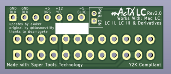

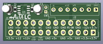

Since I felt like procrastinating all afternoon.... I did an update to the mAcTX LC. Assuming they work, I'll have a handful to pass around.
These are based on the version uploaded by @blueskykitty at https://68kmla.org/bb/index.php?threads/mactx-lc-boards.38912/
I've uploaded them to Github for easier tracking:
I'm still working on making sure the BOM is correct and that everything works correctly.
Screen Shot 2022-02-20 at 4.55.33 PM.pngScreen Shot 2022-02-20 at 4.56.36 PM.png
