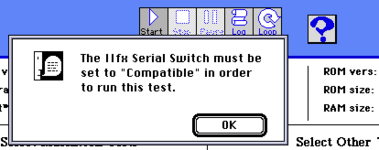

So, I dragged another IIfx out of the basement. Booting into System 7.1 produced the same SCC failure. This IIfx motherboard is pristine. There is no way the SCC is bad in both computers. It can't be a bug either, as the test stops at this point and so a bug would have been caught. Only then did I notice the little question mark button (marked '3' above). Clicking it produces the helpful alert below:

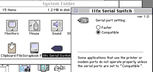

Okay. The IIfx Serial Switch control panel is in the System Folder for the IIfx test software. Set it to compatible and reboot. (Aside: it sets a bit in PRAM. So, the serial port setting will stay that way regardless of the disk you then boot from.)
The SCC test still failed running in System 7.1.

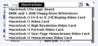

One last note. There is a menu with a number of images.
Pretty cool.
