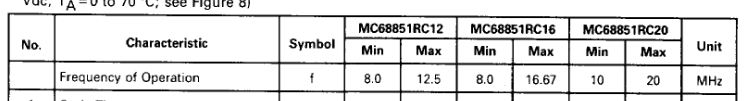

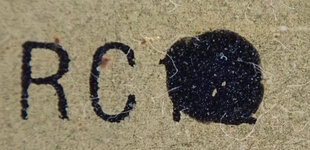

This 68851 MMU was originally certified and labeled as 12 MHz. Yet, someone has covered the speed with a little black spot. The proper certified speed in the Macintosh II should be 16 MHz or better. So, was this a Motorola remark based on re-certifying the speed perhaps due to low demand for the 12 MHz parts? Or, was this a third-party cover up when they sold it as a Mac II upgrade?
I did gently wipe the chip with isopropyl alcohol to clean it, and the black spot did not fade or run. I did not try to remove the spot, as it is more interesting than an unadulterated chip.
I'm pretty sure it says "12" underneath the black covering. 12 MHz was a legitimate speed grade.

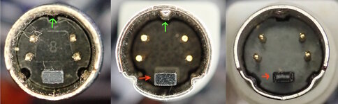

The TechStep has a bunch of cables that connect to all of the various Macintosh ports. However, I could not get the supplied ADB cables to fit in the Macintosh II ADB ports. The supplied cables fit perfectly on the IIfx and other misc Macs I had laying around.
Here is a close-up of the supplied cable (lest), an Apple branded ADB coiled cable (middle), and another Apple branded ADB coiled cable (right). They differ in the shape of the outer shield, the size of the shield alignment bumps, and the size of the internal plastic key.

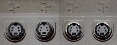

Below, inspecting the Macintosh II ADB port (left) vs the Macintosh IIfx ADB port (right), they look different.. The pin hole shape and chamfer is rectangular on the Macintosh II, but circular on the IIfx. The size of the 'mouth' for mating with the cable's plastic key is larger on the IIfx. Both Apple cables fit in both types of ADB sockets. There must be enough intolerence in the original Macintosh II ADB port to prevent the modern ADB (s-video?) cable from fitting.
Checking out my other computers, my early 800K drive SE has the same rectangular-shaped pins as all of my Macintosh II computers. My later SuperDrive SE has ports like the IIfx. Somewhere along the way, Apple must have changed manufacturers or the original manufacturer improved the design. Even the type of plastic seems to have changed to a harder and crisper formulation.
\I'm pretty sure it says "12" underneath the black covering. 12 MHz was a legitimate speed grade.
