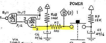

Attached is a schematic for the Macintosh II. Note that the part numbers are wrong (frustrating!) as you have an earlier board revision.
Here's how I approach the repair... I start at U9 on your board (B2 on sheet 1 of the enclosed schematic). This is a 74HC132. Pin 14 should have 4.3V or higher coming from the battery. If not, you have a battery problem.
Pin 2 "1B" is the signal from the power switch. It should be high (4V+) when the power switch is released and low (~0V) when the power switch is pressed. If not, a trace is broken somewhere between the power switch and pin 2. This is common.
It is best to fix the trace. But, if after careful searching you can't find the break, you can wire a bodge wire underneath the board. Go from the power switch to the 100 ohm resistor (which then goes up to pin pin 2 of U9 aka B2).
