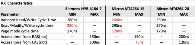

It also isn't clear what the speed of the original 128K chips was.  Some people say 200ns and others 150ns.  The JAMECO RAM chips are mentioned as being 150ns, which indicates they must be the Siemens HYB 4164-2 chips mentioned in the datasheet they provide.  But if we compare the A.C. Characteristics on page 6-16 of that Siemens Datasheet to the same A.C Characteristics on page 1-4 of the Micron MT4264 datasheet, we see speed differences even between the 150ns chips...
(The Micron MT4264 (-15 or -20) were the stock chips used by Apple in the 128K motherboards.)
I am going to guess that the speed differences between the HYB 4164-2 & MT4264-15 are "within tolerance" of whatever the Apple 128K motherboard requires, but if anyone knows for a fact, please chime in.

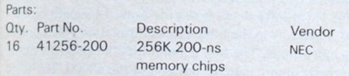

On the page numbered "21" in the Dr. Dobbs Journal PDF, we find this...
That tells is the stock 128K RAM is rated at 200ns speed (which means any of the 150ns or faster chips should work perfectly fine), and that Dr. Dobbs article suggests using p/n 41256 when swapping out the 64Kx1 RAM chips in a 128K board to yield 512K of total RAM.  Looking up that 41256 part, we find this JAMECO 41256 datasheet which matches this secondary info I found searching the web...
