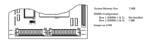

So, I *believe* you need install the RAM in slots 3 & 4 (in the photo they're in slots 1 & 3). Then you need to move the jumper to the 2/4M side (in the photo it appears to be on the 1M side).
If that doesn't work, try the RAM in slots 1 & 2, but from what I understand the RAM on jumpered versions of the logic board need to me in slots 3 & 4 (I don't have a jumpered SE to confirm this, but the documentation I can find seems to indicate it).
(edit: yes, technical docs confirm the use of slots 3 & 4 on your motherboard version (page 3: https://www.tech-insider.org/mac/research/acrobat/9204.pdf )
