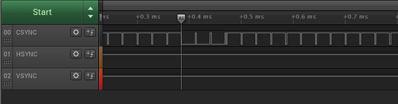

The Toby card puts out CSYNC on pin 3, and it's a TTL level signal swinging between 0 and 4.7V, but it's not the same as the IIci and IIsi CSYNC: the period around the vblank interval looks different. First the CSYNC pulses become twice as frequent as normal, then CSYNC goes low for the equivalent of 3 horizontal line periods, then more double-speed CSYNC pulses, then finally back to the normal pattern. I think this is an NTSC/PAL thing, something called serration pulses? The other Mac video signals that I've looked at don't have this. Here's a capture:

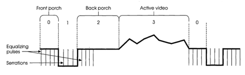

This is a strange beast. My vague understanding of these serrations or equalizing pulses is that they're an NTSC/PAL thing, not something used in Mac/VGA video. It clearly wasn't needed for the Mac, since it was eliminated in later video cards that still work with the same monitors. Then there's this:

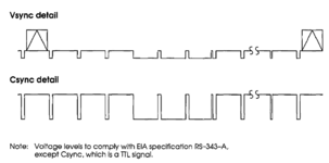

That's not what I'm seeing on CSYNC. I get no positive going pulses on CSYNC during the vertical blanking interval, and this diagram doesn't show the serration pulses with twice the frequency of the normal CSYNC pulses.
