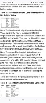

The early ones don't support Sense pins and its weird on these early cards :
