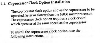

U30 looks like it is for an oscillator.   Perhaps the 68030 and the math coprocesser can be driven at different speeds?
The clue that suggests that U30 is for an oscillator is the fact that none of the pins are populated, except for the corner pins.  This is the footprint of a full metal can oscillator and not much else.
Yes, exactly.
