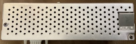

this is a success story about a power supply repair (MagneTek 3231-05-001). Maybe it will help somebody else with the same issue.
Recently my Mac IIsi did not power on anymore. I checked the stand by voltage: 0V, nothing. So I opened the power supply
and saw a broken elektrolyte capacitor (400V 10µF) on the high voltage side. This made me wondering because in most cases the low voltage capacitors spit their insides around. I saw that this capacitor was loaded by the diode beside (one way rectifier). I checked, DC only 100V (in Germany we have 230V AC which makes about 300-320V recitified) but 150V AC. The root cause was the rectifier diode that was conductive in both ways. Changed the diode and the capacitor. Everything fine again.
Regards
Florian
