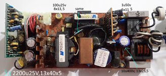

The switching for the standby circuit is controlled by Q3 (BUX85 power transistor, circled up there) and the small daughterboard. Upon checking around there, I eventually found out that Q3 was bad.
After receiving a replacement, I swapped it out, but still no standby voltage. I looked further and found that the resistor next to Q3 (also circled above) was bad too. It's supposed to be a 10ohm resistor, but it was measuring in the megaohm range...
So I replaced that part too, and suddenly my power supply was working again.

I also recently ran into one of those power supplies. Here are my recapping photos and notes...

But, apart from bad capacitors, you should have a look at broken traces or broken components (i can see a lot of rust)

That's dust. The power supply is in good condition, I didn't see any leakage or corrosion.
