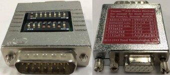

I use a DB15-VGA converter to connect my Eizo L367 display. (Left, for reference only.) Unfortunately, there are no video signal and no sound when turning on the Mac II ci.

honestly should have guessed. the mac IIci internal video is somewhat picky and won't work with hardwired adapters like that
try to find an adapter with dip switches, best if it has two rows.
