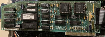

Opened up both IIGS units. One of them had the Sandwich II Apple SCSI card, so I shouldn’t have any issues running the external drive:

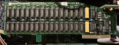

I also had two Apple memory expansion cards. One of them is fully populated (I think that gives me 1MB - could be wrong):

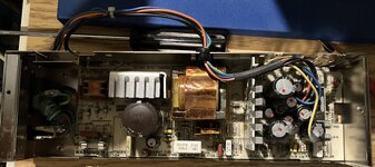

Original power supply (RIFA cap I’m looking at you):
