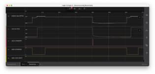

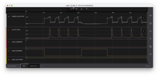

I was lucky to land a non-working IIcx on the cheap. It looked better than it really was; the PSU would not stay on but would instead rapidly cycle on and off. After a basic recap, nothing improved. Lifting one of the chips in the PSU on/off support area (under the FDD/HDD caddy) revealed a lot of corrosion and grime. I replaced all the gates/diodes/transistors and, since they also looked corroded, the six bus latches between them and the ROMs (totaling nine SOICs and multiple SOT-23s) . I cleaned as I removed and new parts got nice bright pads and a grime-free area. This went really well, with only two (out of about 120) pads lifted; I was able to place solid, quality bodges to repair those.
That system now proceeds to boot if the load is low enough. Before the chip replacement, the PSU just would never stay on at all, and the ADB power key did nothing. Good news: the PSU logic replacement seems to have been correct; the power button on the rear of the IIcx as well as the soft-power on the ADB keyboard behave as expected. Bad news: Trying to boot with an HDD attached gets me back to cycling on/off, but that is unlikely the fault of the rework. Removing power from the HDD lets it proceed. Possibly +12V0 pulling down the whole system?
Progress! Now, step two: once the PSU locks 'on' (eg with no HDD), I get instant chimes of death, minor-chord-then-four-rising-chords.
OK, so I am about to pry open the PSU and try to improve its voltage regulation. I am not an electrical engineer. I know just enough to be unsure that a simple recap of the PSU will improve the regulation. I am wondering if I should look into replacing any semiconductors. I'll follow up on this topic when I get that far.
