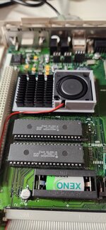

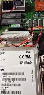

so got bored overclocked my LC3 with the resistor mod. It was getting hot, so I made a custom cooling solution

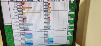

keeps it cool when running benchmarks and whatever else
any thoughts? 20240505_152026.jpg20240505_152139.jpg20240505_152030.jpg20240505_152152.jpg

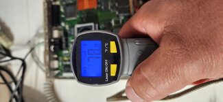

Yeah I noticed with the case on it got very hot and with thr case off it was hitting 100 f 😳 so now it's nice and chilly

According to the manual, it appears that the 68030 is designed to operate between 0° and 70° C, which means 32° and 158° F, so if it's running at ~100° F, I'd say we're golden. Of course, the IR camera just reads the external temperature of the package, but even so, that seems like a good enough place to be in my mind.
EDIT: Just saw that @danny.gonzalez.0861@gmai already posted the temps, derp!
