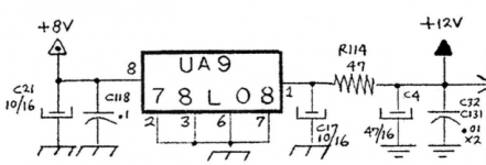

At least on the LC II, there's a 78L08 8v voltage regulator right beside the DFAC that the DFAC relies on (I know this because mine fell off and sound stopped working, which led to a certain amount of perusing of schematics).  Looks like it's there on the LC as well.

Huh - so 8v is the expected output from the 78L08 for the DFAC? I may go test this in a minute...
Yup, the number after the L in that series seems to be the voltage.  According to the Bomarc schematics for the LC II, it produces an 8v supply:

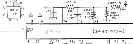

which as far as I can see is consumed only by the DFAC:

(Disclaimer: I don't really know what I'm doing here, but the 78L08 fell off one of my LC II boards when I was washing it/recapping it this afternoon, so I had an "oh dear, I wonder what that did" moment.)
So it might be worth checking whether you're getting getting a stable 8v on pins 3 and 4 of the DFAC.
Welp, it's the DFAC. It was getting a fairly close 8.11v (I would assume is within the DFAC's tolerance range), so I pulled both it and the 78L08, cleaned the area, added some fresh solder and reinstalled. Bupkis.

Got the DFAC replaced with one from a very much dead Classic II (RIP, old friend) and audio is back! The LC lives again.
