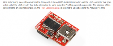

The analogue stick module is a cheap eBay one (there are tons of sellers; that was just the first one in the list) that I seem to have ended up with a number of, which is just a couple of variable resistors acting as voltage dividers and a pushbutton switch. The microcontroller is an 5v Arduino Pro Mini, which is gross overkill but does work.

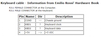

The code that sits inside it is here. It's a bit of a mess, but if anyone else is interested I'll clean it up a bit. Assembling one is pretty easy; the pins are set by default so that all the wires from the joystick thingy go to one side of the board, and all the wires for the cable to the computer (except for +5v, unfortunately) go to the other. Two digital I/O pins are used to provide +5v and 0v for the joystick's voltage dividers.
