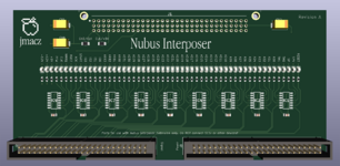

I got tired of trying to probe signals on my various video cards while the card was installed upright on a motherboard. Drawing inspiration from @zigzagjoe (and some of his advice), I put together my very first PCB using Kicad.
I probably made a ton of n00b design choices here but hey, this was my very first attempt so don't laugh. 🤣 (that means you @bigmessowires!)
This is part one of a two part Nubus Interposer. The primary goal is to allow me to leave my video card on my work surface but still have it connected to the motherboard and running. I have only manufactured this bottom part so far and all the connections on this part are good with functional LEDs showing that the power rails are good. This will use standard 50 pin internal SCSI ribbon cables to ferry the 96 nubus port signals to a video card sitting 12" away. I have no idea whether this will work given the distance, noise, etc. But even if it doesn't, I learned a lot from playing with Kicad and attempting this so it was worth it regardless.
The other part is where most of the "fun" stuff is... lots of lights! But I have yet to manufacture this part as I'm still figuring out how to get the assembly stuff working with JLCPCB as there's no way I'm going to solder all the LEDs and resistors.
At some point I'll stop staring at it trying to find any costly mistakes and cross my fingers and place an order. Again, probably made a ton of mistakes here (not connections but more the theory, design choices, etc). But I guess I will find out.
One thing I did find interesting though having spent a lot of time in CAD/CAM software. It's very possible I just haven't figured out how to do this yet, but I'm so accustomed to parametric modeling that I was really looking for constraint tools in Kicad so that I can put in rules for the layout. For example use a variable to define the distance between LEDs and other components so that an edit of one value automatically takes effect all over the design. Is that doable? Like can I define a dimensional constraint saying that the ports are always 3mm away from the PCB edge so that as I move the edge, the ports move to that constraint? I could not figure that out but that would have been nice given the number of components.

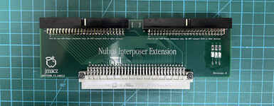

Been really busy at work for the past month.. but got some time today to open my package from JLCPCB: Nubus Interposer!
My first attempt at designing something in Kicad and getting it manufactured at JLCPCB. :)
The above is the extension board that plugs into the nubus slot on the logic board. And..
this is the main board that plugs into the actual nubus card, in this case a video card. It looks to be working. I am able to use the video card while it's sitting on my work bench so I can more easily probe and potentially debug things. Hope this comes in handy to finish debugging the three SuperMac video cards I have that have some issues. And the blinking lights are a nice plus. Thanks for the help @zigzagjoe!
Yes, those are 50 pin internal SCSI ribbon cables. Needed a flexible but cheap way to connect the two halves. I am sure I have a lot to learn in terms of noise/etc that I got wrong here and will need to learn for future projects. But it is working.
