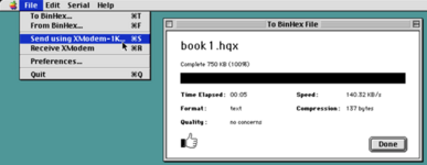

How'd you get a serial transfer going at 140.32KB/sec?
I wish! The image above is showing both the primary operations of the tool. It can send BinHex files (which the user is about to choose from the File menu) and it can convert files to/from BinHex (which the user previously did in the progress window displayed).
Or, put simply, the 140.32KB/sec was the speed of converting a file to BinHex on the disk, not sending it over the serial port.
