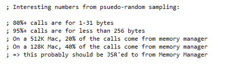

1. In the ROM source code BlockMove.a, check out what Apple developers concluded about the usage of BlockMove:
The reference to a 512K Mac suggests the analysis was performed in the early years.

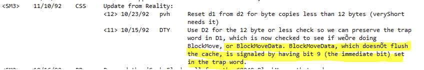

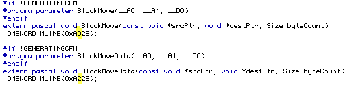

In late 1992 code, Apple introduced a special variation of BlockMove called BlockMoveData that does not clear the instruction cache. If you are certain you aren't moving code, this is the faster call.
This option is not mentioned in any of the original Inside Macintosh books, nor the follow-up Inside Macintosh: Memory. The books were published before Apple shipped a ROM or system with this code. Because it just has an option bit set, presumably you can call BlockMoveData before the code existed and it will just execute the normal BlockMove trap. Apple updated the Universal Header Memory.h at some point:

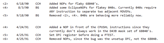

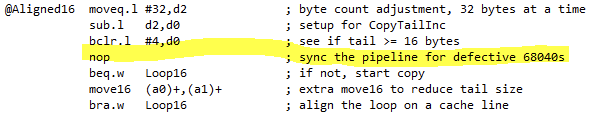

4. In 1990/1991, the BlockMove code contained NOP hacks to compensate for defective 68040s.
The 1993 code still contains NOPs throughout the ROM. I guess this is a different defect that made it into shipping Macintosh CPUs.

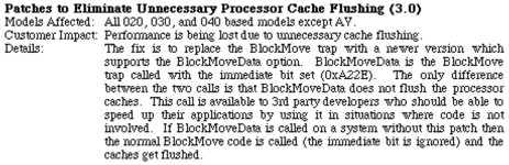

Interestingly, I happened to discover this was actually documented in the System Update 3.0 technical notes:
Thank you for that information. It is helpful to confirm that using the new call won't fail in previous systems. System Update 3.0 was released in May 1994.

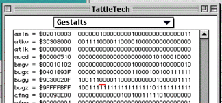

Running 7.1.2 System Update 3.0 on Basilisk shows that the gestaltBlockMoveDataPatch is installed, but 8.1 indicates it is not.
Perhaps this is because 8.1 already includes the code and thus doesn't need the 'fix'. But, that's not how a Gestalt flag is supposed to work. It is supposed to indicate when a feature is present -- regardless of whether by native support, init, or patch.
