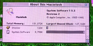

I want to pass out the cigars and announce a new birth! My baby, my IIcx.. the machine that holds some very nostalgic value for me... has come through the operation with flying colors! He’s resting in post-op, but that op was a success! I have given birth to a IIcx maxed out with 131MB of RAM!
I heard the friendly chime... I threw up my arms in triumph. Start-up held on a dark screen with an inverted smiley Mac icon (something that seemed to be happening before the new RAM came along), but after about a minute, the extensions loaded, the Godzilla startup sound roared out, and, behold...
Thank you folks. A very simple solution. I didn’t want to put all of the SIMMs in until I was sure they worked, but that is the very thing that kept them from working... doh!
