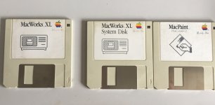

I have 4 disks fitting to the Macintosh XL.
- MacWorks XL - the start disk to change you Lisa into a Macintosh
- MacWorks XL System Disk - the Macintosh OS ( I have this disk double)
- MacPaint - Macintosh System Disk with MacPaint on it
