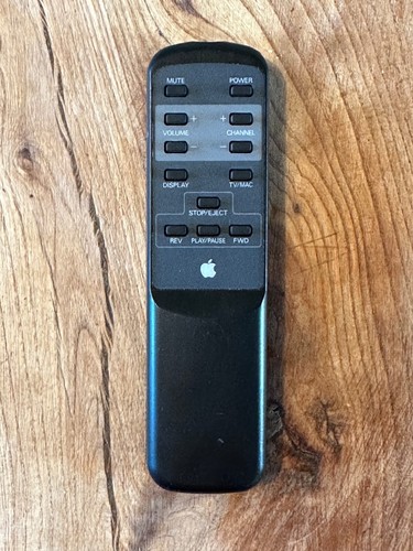

Don't forget to grab a remote - you can wirelessly power your mac on from over the room!
Random ebay listing, best search for ones with cheap postage to you :
