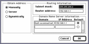

@cbmeeks MacTCP doesn't actually do DHCP, it's actually BootP or RARP. So it's unlikely to work with your modern router. You need to set your MacTCP to manual. Below are the settings I use on my Macintosh IIci. I'm using version 2.0.6 which doesn't bother with Net and Node settings. It appears to work. I also have an older 10/100 Netgear switch between my vintage equipment and my modern equipment.
Just swap out the DNS for yours and make sure to put in an available IP address.

If you really want to try Classic Networking then use MacTCP 2.1. Enter the IP manually. Following the instructions above, and I've had luck using my router's IP as DNS server IP as posted above with a . in the Domain field.
