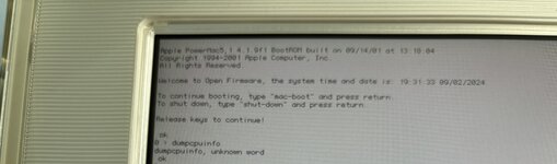

I'm currently in Open Firmware, but when I input the "dumpcpuinfo" command, it tells me that it is an "unknown word". Am I doing something wrong
index.php
here? I'm not too well versed in Open Firmware commands so I apologize for my lack of understanding.

I've typed all the lines and this is what I got. View attachment 77879
So L3CR isn't enabled in Open Firmware.
Does someone have a G4 Mac where L3CR is enabled in Open Firmware?
L3CR is not affected by Open Firmware code but it is affected by HwInit code which happens before Open Firmware. I don't know what the code changes in the L3CR or what's required to make it do the changes. Perhaps it's reading the L3 cache info from the config-block as described in the Configblk_2.5.15.pdf document. I'm not sure if that document is 100% accurate. It does not match the layout of the config block used by the G4 Cube (the Cube has firmware 419f1 but the config block in the document is 436f1). If we assume it does match, then the config block for the G4 Cube has an empty L3 cache section.
Code could be added to the PowerLogix/NewerTech firmware patchers (NewerTech is the newer version) to modify the config block info but you need to figure out what bytes of the config block need to be changed - by understanding the HwInit code.
