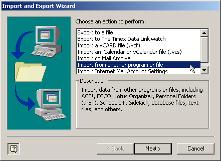

OK things are getting interesting. I have figured out how to turn the folder of emails into an "archive".
AND that "Microsoft Importer for Lotus ccMail Archives" app is able to read these messages and properly import the right amount of messages!!!
But here's the problem now. I have no idea what it does with the mail it imports!?
^ this is what it tells me. Obviously there is no exchange server running on this machine. It's just a regular Windows 7 virtual machine. I was hoping this little app would convert the archives into something that I could directly import into Apple Mail. Looks like I'm not quite that lucky.
Holy shit it's working!!!
So you go through these very odd, very non-intuitive steps to create an archive, and move all the mail to the archive.
Then you move that archive over to windows and run that exchange importer tool. That creates a .pst file in your documents folder.
You move that .pst BACK to mac, and import it into Outlook for Mac.
Then you export that mailbox to an .mbox file.
You import that .mbox into Apple mail and HOLY SHIT you have recovered mail!!!
