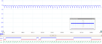

Tried building and running this circuit with a test PIC (not the 12F1501 yet) and it doesn't seem to be having quite the desired effect:
The scope is reading the value of HSKi from the collector leg of the transistor, the logic analyzer's HSKi line is reading the value of RA2. The fast rise of HSKi is coincident with RA2 going low, maybe I overdid it with one of the resistor values?
Aha! Switched out the 3.3 KΩ resistor with a 470 Ω resistor and the waveform actually dips below zero for a reasonable time now. The waveform is still kind of pointy at the bottom, but it works well enough to send a test sine wave to SoundEdit. Thanks @ymk ! I'd be happy to hear any suggestions how to further refine this.

A little more story... I went hunting for trouble and asked in ##electronics on Libera about how I could improve the shape of the waveform being output by the 2N3906, and we determined that the 2N3906 I was using either was defective, counterfeit, or not a 2N3906. Weird.
