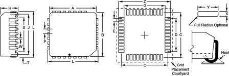

There seem to be a few listings for thruhole sockets and plenty for SMT Socket listings. The sockets on Performer boards for the Classic look deeper, is that the problem and neither available socket type is usable?
Dunno, confused. Found these looking for the SMT pad footprint.
