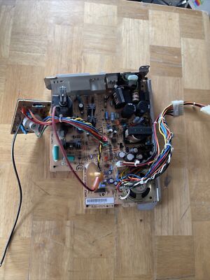

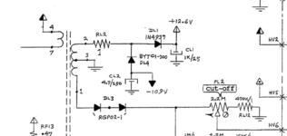

I spent the last 2 days recapping and cleaning this Classic II, 220v, and I'm extremely unappy to discover that I have nothing out of Pin 2 of the flyback transformer, there is no 12.6v output to the pin 2 of the TEA2037, everything boot and I have a bright horizontal line on the screen,event the NMI does sounds, I just spent the entire day recapping the AB after recapping the LB and my heart it's broken.
I can't seem to find any flyback transforer, so, I have been thinking, if a +12.6 it's everything I need, can I cut RL2 (spoiler, I already did to check for shorts) and feed a regulated 12.6? how bad would it be?
That or I'd pull the transformer and verify it's bad with an lopt tester. They used to sell a cheap kit you could build (dick smith)
