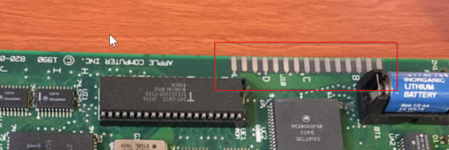

For future reference - a flat head screwdriver and care is ok for a ROM chip. Best is a wide and thin one so you can get it in the gap at the end. Once it starts lifting, angled tweezers work really well to lift evenly, one side at a time, *between* the pins.The problem might be this general area, but as far as I can tell all the traces have proper continuity (I've done quite a bit of prodding here):

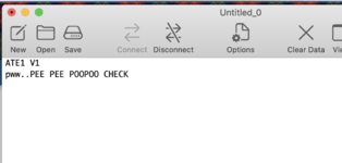

Specifically, it might be that one of the traces from the ROM to the CPU is messed up, if that code is indeed something about illegal ROM instructions.
I have not tried to reseat the ROM, because I lack a tool I can use to do it without damaging the pins.
