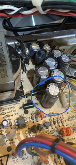

ok, now this is pretty frickin' gross. You're telling me these electrolytic fluid-soaked power cables had a short? insanity.
Edit: I followed the guide for which capacitors to buy from RecapAMac and, although I wasn't able to see it because of the angle, it turns out that the 470uf 50v capacitor on that guide is, in fact, a 1000uf 35v capacitor on the American power supplies. Gonna have to buy a new cap, but before I do that, does anyone have part numbers for these other bits? I took them out to clean, and since I have to buy a new capacitor anyway, if I could also pick up equivalents for these it would be nice, in case any don't work.

Also, if anyone was wondering, the short on the analog board is actually visible in my previous post. The 12v rail was arcing to ground via the speaker metal, and you can see it is corroded and melted there.

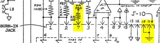

As for the pin that needs to be grounded, is it this one?:
If so, do I just need to run a wire from it to some ground plane?
