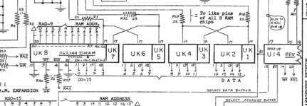

That error is something we can work with. I just took a brief look through the ROM source. It tries to write successive bits to identified memory and verifies that all bits are correctly read/written. STCrittests.a is where DataBusTest is defined.
To translate the sad mac, it is saying test failed on data lines D8, D9, D10, D11 (0xF00 -> binary results in 111100000000). 4 bits is a common width of a RAM chip, so it sounds like you've got an entire chip incommunicado. Based on schematics, looks like UK4 and UK3 are responsible for those data bits. Looks to me like data bus test only is going to be testing one of these chips, not both, but I am not sure which lies where in address space, so you will want to check both chips as potential issues.
My thoughts on troubleshooting:
  1. basics first: make sure VCC and GND are good on each chip
  2. R19, R18 are populated
  3. Verify R18 has continuity to Pin 17 of UK3
  4. Verify R19 continuity to Pin 17 of UK4
  5. Check continuity of at the other control lines such as OE, W, RAS.
    1. You should be able to cross check those signals against other RAM chips as they are all connected identically across each RAM chip. So check pin 3 of UK8 against UK4, and pin 3 of UK8 against UK3 - and so on. Any other RAM chip (not UK3 or UK4) should be fine.
Below is excerpt from the datasheet for those chips, because the bomarc schematics are painful to read.
