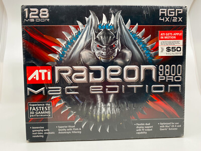

If you just want OSX and want to use the G4, then a 1.6GHz upgrade and a Radeon 9800 Pro (G4 version) might sort your issue ;)
Don't pay this much (this is likely a dual DVI version, but probably worth the sacrifice of losing ADC if you found the same card for $100, or whatever you're willing to pay)

The Mac edition 9800 Pro is an AGP Pro card that gets power from the extra slots and is meant for G5 AGP towers and won't work in a G4. You can mod a PC 9800 but good luck finding a working unit that doesn't cost a bunch since PC gamers lust after them.
https://www.techpowerup.com/gpu-specs/radeon-9800-pro-mac-edition.c2233#gallery-1
I think there is more than one version. The one I linked says AGP 2x / 4x in the box, and the one I own is from a G4 (genuine Mac card, bought as an upgrade).
Hmm I didn’t know that. Mine is a flashed PC version and it is rock solid in my MDD.
