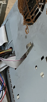

While I was working on my beige G3, this spring piece fell off. I didn't see it happen and can't figure out how to put it back on.
It looks like it goes on the bottom of the tilt-out section with the power supply and hard drives, but the little tab to the left that you can see sticking up doesn't have anything to go in to. I'm wondering if it got bent up and it should be bent down as there is a small square hole in the case that would match up.
And here’s a pic of my own Beige G3 with the clip. It hooks round the opening for the drive data cables.
Not sure why yours is longer…
