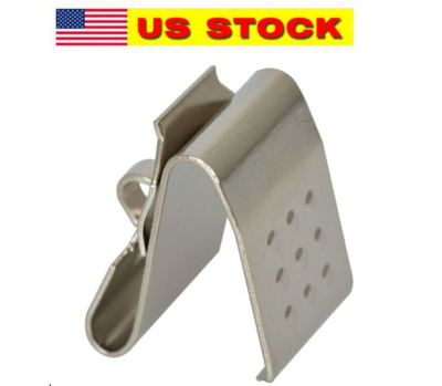

Interesting. If you can get another battery holder of about the right size and borrow the contacts. Or buy some like this (from somewhere cheaper) meant for an 18650 battery? You might need to make a bit of a mod to get them to fit.

Thanks for the hint. That battery contact would be expensive to me due to shipping cost to Switzerland, but you gave me the idea and in Aliexpress I can see many options that maybe I can adapt to fit.

Txs. As there's still half of the old contact, I think I'll be able to fit something...

I can't find a photo of the rear of the terminals to see what type of fixing mettod they use (there are at least three styles I've seen).
