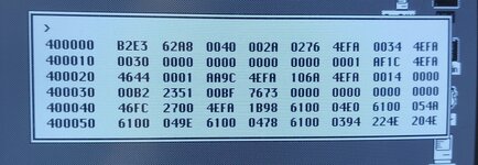

Ok, I can get to it if I press it after "Welcome to Macintosh" and before the accelerator's extension loads.
This is 400002A...

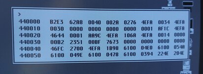

... and this is 44002A... It's different. Bah. I was hoping they'd be identical!

Ahha! @cheesestraws @Arbee! So I powered on my SE while holding the interrupt button, which is what you do to completely disable the 030 upgrade. Booted as a 68000, pressed interrupt again (doesn't crash now) and got the following - 440000 is a mirror of 400000! This means that adding the next sequential address line from the CPU should allow you to use a 512k ROM, because the ROM is enabled when reading 440000 (assuming up to just below 480000).
@bigmessowires - ROMinator for the SE? :)
It's looking like it just needs a custom board to plug into the two ROM sockets, and a mini clip or soldering a wire onto an address pin on the CPU (or somewhere else that it is available.
