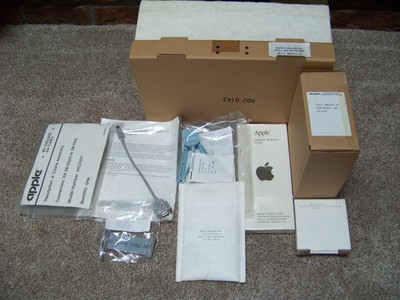

Apple Macintosh II Bus Master NUBUS card?
So, basically, what you're saying is that Apple likely included the Bus Master card with the diagnostics kit, because using a software tool, one could verify the NuBUS works on a Mac by the diagnostics accessing and probing the Bus Master card? That's my take-away from that.
Essentially, yes: not all features of the NuBus are accessible without the card installed, so to fully test the NuBus, you need the card installed. That's my best guesss, but it's only a guess.
