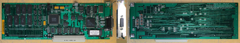

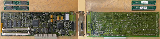

Anyone know what this NuBUS card might be?
This is what I've thought as well from my research. My card came with 16-bit working via its original 341-0266 ROM and even after PRAM reset, all I could get with 832 x 624 sense pins was a black screen when 341-0812 was inserted into the same card. Not even mono or 8-bit.
It sounds like someone pinched the Rev B ROM out of your card?
I think mg.man's ROM is also Rev A to be honest, excuse it is copyright 1990, but it could be from later in the year :) .
Does anyone know what Brooktree part that Bt RAMDAC really is, underneath its Apple disguise?
I've done some more guess-searching on this...
The 8•24 has thicker traces for each of the color channels reaching the DA-15 plug. They're each routed behind L3 on the backside, and reach pins 27, 28, and 29 of the PLCC68. Pin 26 connects to the ground plane and Pin 20 connects through R22 on the backside to C45, along with D7 on the front near the ROM.
The pathing on the earlier 4•8 is a bit more comvoluted but corroborates the 8•24.
I did a quick image search for 'plcc 68 ramdac brooktree' and found two PLCC68 RAMDACs, Bt473 and Bt485.
To disclaim, I'm out of my depth here; Bt485 seems to support more features than the Nubus cards were sold for, though Bt473 seems more likely to fit the description. Neither fit the pinout required by the 4•8 and 8•24, though. Maybe still a good jumping-off point?
The BT484/485 are unlikely candidates, they are probably newer than the 8*24 GC - they're not listed in the '89 or '91 databooks, but appear in the '93 handbook (see on bitsavers) with a 84-pins PLCC package. BT473 is the only one I find in the databooks with a 68-pins PLCC package, but as you say that's the wrong pins on the board for the analog outputs of the BT473.
OTH, Brooktree made a lot of products, and not all variants may have made it to the databooks - I've seen devices with higher frequency labeling than the databooks say are available. It's also possible Apple was using a custom package for otherwise 'standard' BT silicon. Ot hey could have had the silicon customized.
Theoretically, it should be possible to reverse-engineering the ROM to figure out how the RAMDAC is set up (color palette, ...) and so to which family of BT RAMDACs it belongs. But that would be a lot of work.
