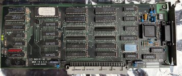

The other one is Radius Mac II Two Page Display Adapter. There are a few chips on it, but only 4 look like VRAM. And again, it's the 41264-120 - just in a different package: 24pin plastic ZIP instead of 24pin plastic DIP. The other chips seem to be GALs and Bus drivers etc.: M74ALS646P, SN74ALS573....

The last card is a Radius Precision color 8xj
You should be able to look up everything from there, but the resolutions are :
512 x 384
640 x 480 @ 66.7 Hz or 60 Hz
800 x 600 @ 75 Hz
832 x 624
1024 x 768 @ 60 Hz, 65 Hz, and 75 Hz
1152 x 870
1152 x 882
