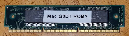

Hehe... I am planning another trip soon - but I think I might have a spare G3 ROM over here. Might be a fallback plan tho.unless we can get @mg.man to travel again.
Do you have any pics of the A/B/C ROMs? Will help with my local investigations.Rev. A, B or C?
Just to muddy the water, one of my Beige G3s has a 4-chip Rev A ROM.They're different from other ROM modules of this form factor in that htey have 2 slightly longer chips on just one side instead of 4 chips, 2 per side
That's your best bet. The issue is that they're difficult to see in photos, and sometimes you see chips with the standard rom part labels, not the Apple part. I think both of my Rev A simms don't have the apple chip numbers, I can see "SEC" and AMD's logos.I'm mainly going by the -S0402 and -S0403 P/Ns on mine.
Will see if I can fire up a G3DT or MT to confirm.
