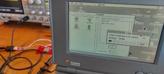

Thanks Ales :) and I can announce that
IT WORKS!!
Here it is! I connected the connector pins manually since I already had cables coming out the machine. There was a problem with the 3.3 buffer, but in the end it is good since I have a chance to debug it before the next run of boards.

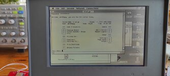

There are two servers: mini vmac running on my MacBook, and "anselmo" (sorry for the silly name) which is my Linux PC, running netatalk, running my localtalk tashtalk driver, connected to my makeshift LT2USB, connected to a real AirTalk :) And it works! I could print wirelessly too! (the serial adapter in the photo just gives power and is connected to the debug port of the ESP, no localtalk goes there ;) )
MacIP via MacIPGw + localtalk kernel driver + airtalk works too!
