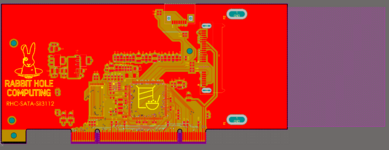

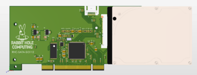

A high-quality SATA PCI 2.5" hard card, to celebrate SATA's 20th birthday
