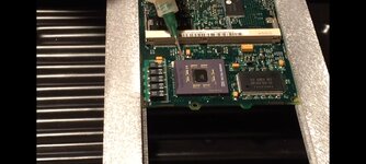

I had one sitting around, so for grins I put an 800MHz 750F CPU into the Pismo. The firmware reports the speed incorrectly (as with the 750G), but OS X does not need a patch to run. I keep hoping someone with one of the Powerlogix upgrades will chime in with a firmware dump! :)

I could not get CPU Director to change speed using the dual PLL options, and Reggie SE will not let me do it either (it can only read registers I guess). However, I found a utility in the Powerlogix folder called plxsetspr that does let me make changes. So the dual PLLs are working!
