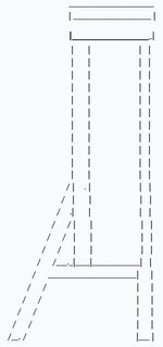

Here's a laminated project directly OT for your project. thicken the left leg quite a bit and convert the other to full height from"bottom of TowerIIfx to top" with venting and width to filled out to 5.25" PC FDD width platform at top. Maybe allow provision for power distribution switches a/o ADB switchbox implementation up along the way.
ASCII playtime is up, didn't work anyway. Drop out extra carriage return to lower profilet of the 5.25" PC FDD/CD SlotLoader hack and you get the idea. Buts up against the right file cabinet under desk. ;)
Should have used pencil and paper, but ASCII art is too ingrained in my internet . . . you know . . . WWWfree zone of the day. :rolleyes:
