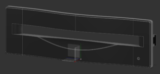

The only part I am not really sure about are the two flang/clip things on the rear right side. I have like 3 different bezels in front of me, and none of them have any of those left, attached or otherwise. If anyone out there can take a picture and/or measure of a non broken one
@Swolfington Quite an old request but just in case: the drawings for this part (Q800 CD bezel) are in the Developer Note for the Q800, as one of the foldout.
Thanks for the link! I came across that as well way back when and it was a tremendous help nailing down some of the smaller details. Incidentally, I actually made the caddy loading drive version of that bezel not too long ago as well. I haven't tried printing it out and I don't have a functional caddy loading drive to test it on, but assuming those technical drawings are accurate, it should work.
